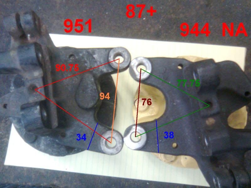

Boxster S rotors are 318mm Dia x 28mm thick. Unless you are heavy tracking constantly or violating municiple codes, you should keep the Boxster S rotors, they are lighter and have a different centering ring.

xschop wrote:Get the 87-up spindles with 76mm caliper ear spacing. I have been running the Cayenne 330 rotors on the Lexus calipers. I had to trim the axial mount interfaces on the adapters from the Boxster S setup because the Cayenne rotors set inwards by almost 2mm because of offset and rotor thickness 32mm compared to 28mm. The I just added 6mm thick washers to step the calipers out. When I get a chance I will make a run of the billet adapters soon.
That's great Rob, please let me know when you have adapters for the 76mm caliper spacing and 330mm rotors - I'll be first in line to buy a set.

I've got a set of spindles off of an '87 944S and I believe they have the 76mm ear spacing. Would this kit work with the spindles I have?

This is the last set I have until I can do more production in January. Only selling the entire kit as I will be designing a new Kit Using Wilwood Integra-6R's for 944,951, and Early 928's Very Happy
The LS430-Cayenne is IMO the best bang-for-the buck front brake upgrade. I rode in Raymond's 951 with them on Boster-S rotors and it realy does put the M030 brakes to shame.

Radial adapters and centering rings $215 shipped USPS priority to US-48. And they only fit 87-up NA spindles. If you haven't seen my post, they are stronger than the 951 spindles.
