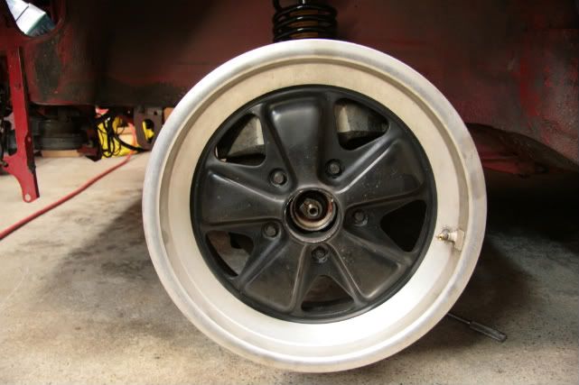

based on the measurements of the caliper and rotor i don't see why a 16 inch wheel wont fit over the lexus calipers

I got a set of the calipers and by doing a test fit a 16 wheel fits over with no problem

They will fit IF the inner manufacturing curvature of the rim allows it. Yes please post pics of which 16" rims will work. Later I want to find a set of suitable snow rims/tires to have on hand....

I'm running them on an early car so I might need a small spacer to push out the wheel, but I'll post up pics later of it under a fuch

I still am waiting on the adapters for the calipers but here is it sitting on top of the rotor
And there is minimal clearance between the wheel and the caliper, plus i will have to run a spacer to push the wheel out a bit.

Hey Jim, looking at your nice Fuch wheel there and LS430 caliper.....is that Lexus caliper setting on the stock front rotor? I just have to ask, because the Boxster S rotor would be a larger diameter than the one based in the pic....If it is, my bad.

318 MM = ~12.5 INCHES...
Inside a 16" wheel? With THAT caliper?

To take that picture yes the stock rotor is on, but if im correct it should just barely fit, or i will have to carefully grind part of the caliper

Hey Jim, it just may fit with a tad more than a 1/4" clearance on the upper portion of the inner rim if that curvature is machined a certain way on th Fuch.....

hey guys its been a while since i've been here, but i have the spacers made and im happy to say that a fuch will fit over the calipers with very minimal clearance. I don't have any pictures since i need to find some reasonably priced wheel spacers, but i will try to get some as soon as i can!
