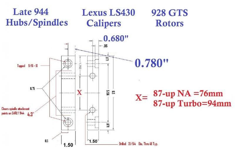

Post  xschop Wed Jun 12, 2013 8:06 am
Get rid of the 86T hubs/spindles and get a set of 87-up NA hubs/spindles....THEY ARE THE STRONGER than all 951 hubs/spindles.
The 928 GTS rotors (322x32) have the 136mm setscrew PCD that matches the 944/951 hubs, therefore no centering ring is needed....
LS430 Big Brake Swap - Page 10 Late944-LexusCalipers-928GTSrotors-1_zps88a47b02

Post  xschop Thu Jun 13, 2013 9:44 am
You would have to redesign the adapter to drop the caliper 9mm radially, not sure of the axial dimension change as I have never measured a 304mm rotor offset, as that defeats the purpose of bigger rotors.

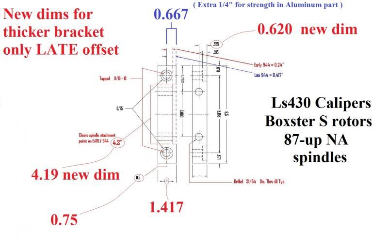

Post  HandofTron Sun Sep 22, 2013 10:29 am
In case anyone else might be looking and find this thread I found the blueprints for ls430 calipers+boxster rotors by creeping on xschop's photobucket
LS430 Big Brake Swap - Page 10 944-BoxsterSrotorAdapter_zps03e6a3ad

Post  xschop Tue Nov 05, 2013 10:27 am
Correct, using the 951 spindle/hub, the adapter will last about two stops as the axial and radial bolts will almost touch and no material will be between them. If you haven't seen my posts, get 87-up NA spindles. They are stronger anyways.
