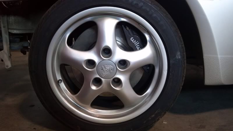

Post  map21 Sun Sep 04, 2011 12:55 pm
Here is a quick pic of how this brake kit actually looks installed behind 17in Cup wheels for those on the fence about them.
