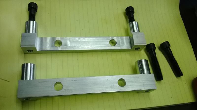

Sent the first CNC'd set to Tim for testing. These are for LATE 951 spindles with 94mm spindle/caliper bolt centers.
While it's fresh on my mind, these use the factory spindle/caliper M12x 1.5 bolts and you'll need 4ea 7/16-14 x 2.50" bolts with short shoulders (less than 1" under head)....

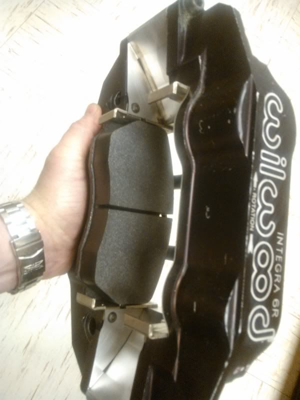

That photo makes them look big!  There are very close in size to TurboS front calipers.  The wilwoods are thinner but wider, which allows them to use such wide pads.  Below is a pic of them mocked up on my car with 330 mm Cayenne rotors (Stoptech).
Compare with TurboS

What material are you using for the adapters?
Posts : 528
Age : 103
Re: Wilwood 6-piston on 330mm Cayenne Rotors
Post  xschop on Fri Dec 13, 2013 1:38 pm
7075-T6
The locating spuds are incorporated into the base unlike the original ones I made for a local guy.

Right now I've got a set of Wilwood Polymatrix A's installed. They are very aggressive, inline the DTC 70/60's. Here are some pad exchange numbers for the integra's
Pad interchange: Wilwood 9828; PFC 7775, Hawk 221, Raybestos R561.28
The new pads are $100 more than for the Turbo S pads but are twice the thickness. Also, lot's of pads available on Ebay for less then $100 from the NASCAR teams.

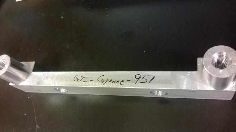

Over the weekend I designed another adapter that mounts these Integras to a GTS (322x32) rotor. It is a beefier adapter and NO centering rings needed. So they'll be $175 shipped US-48 priority.
Thanks to Tim for doing the test mock-up for these. I hope to get the new material today and start machining adapters this weekend for the Cayenne rotors that are more than double the strength. Very Happy

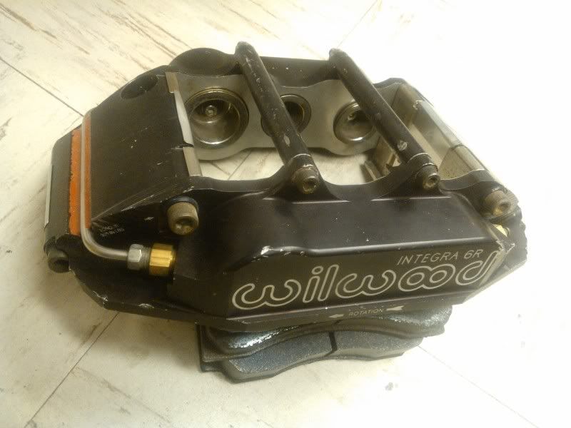

Check ebay for these.They must be the Integra 6R's (180mm radial mount), not the Lug (axial)mount Integras. I just bought another set a few wks ago... gotta love BIN Very Happy
http://wilwood.com/Calipers/CaliperProd.aspx?itemno=120-5690-FS

Ok. I have 1 last set of these until a couple weeks when I can make a larger run of them. These are redone from 6061 T6 with 3x the material around the bolt-thrus and can take over 1000 deg. according to ASTM. I'm leaving the extra material (0.250" at the bottom) so I can redrill them on-the-fly to fit the 87-up NA spindles which are less expensive and more common..... Again, Thanks, to Tim for the mock-up.
