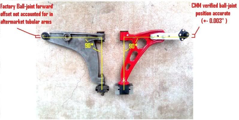

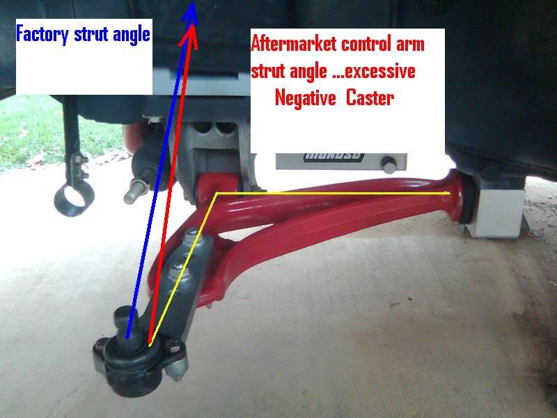

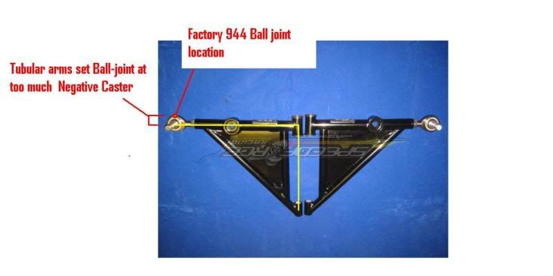

Post  xschop Sun Jan 31, 2010 11:45 am
Yes, they are strong...
Yes, the HARD heim-joints rattle the %#$# out of your suspension and are not protected by boots.
Yes, the Caster angle from the factory suspension is OVERLOOKED.....and serious Negative caster is the result that the 7mm adjustment of the factory castor bolt cannot remove even if it is incorporated into the tubular arm design......
Pics are worth a Grand....
