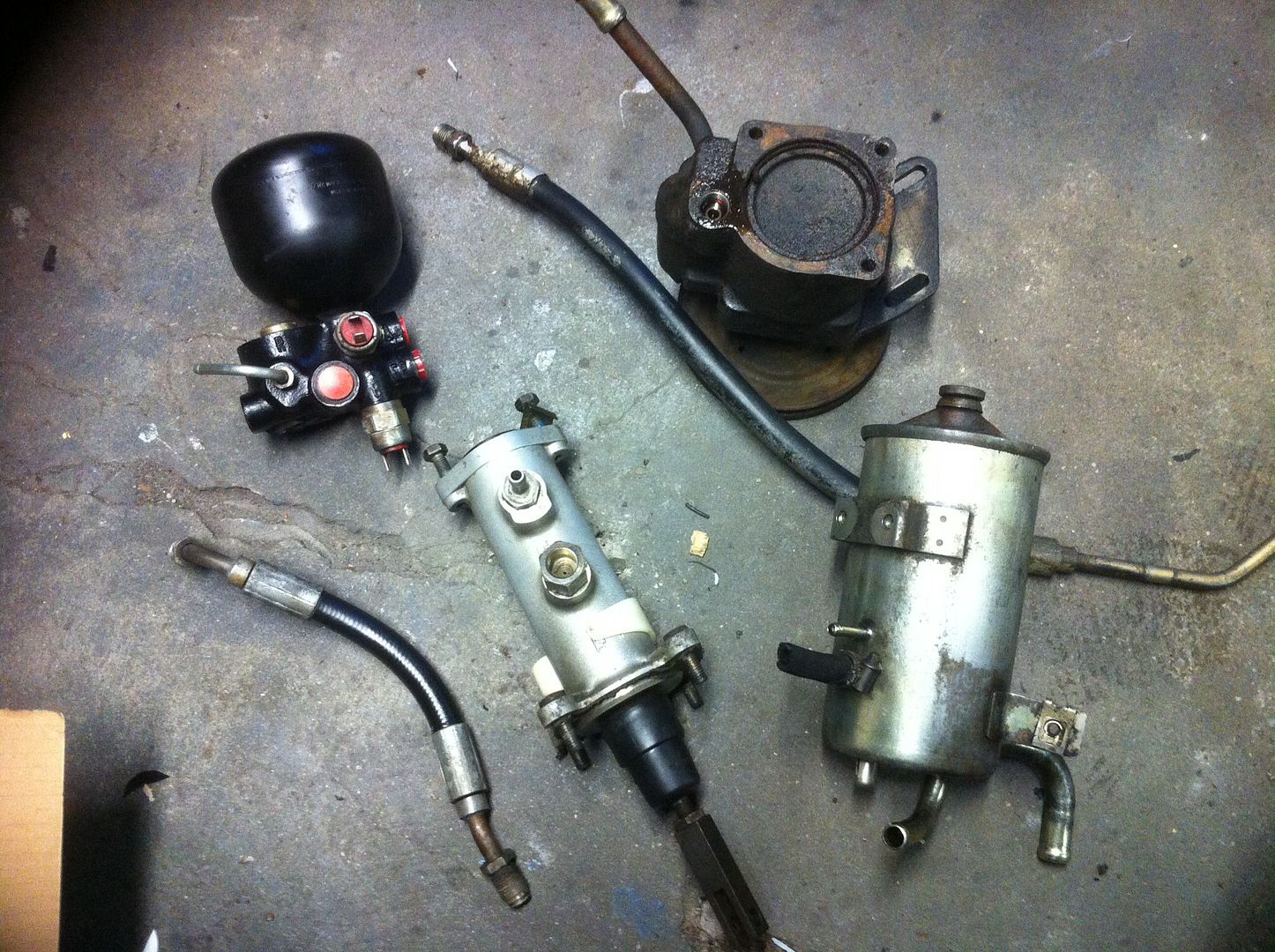

Trying to figure out if it would work. Ls3 mildly tuned.( 525hp )
Brakes manual. Stock porsche Master cilinder? Front big reds, rear original 951 calipers.
Or do i really need more stopping power?
Have either the 5/18 or 5/33 brake bias valve

Is there a how to for the hydroboost setup?
Want to use the porsche ps pump if possible. Is the bmw unit the best option since it can use the porsche mc?

Why do you want to use the porsche PS pump? How are you planning on doing that? Custom brackets, custom belt, custom ???
The best bet is to use the Ford Mustang hydroboost unit with the 951 MC and the adapter you can get from TPC along with a Turn 1 F body PS pump.
Or you can also use the BMW hydroboost system with the 951 MC, but the BMW system is much harder to find and more expensive...

My Hydraboost setup.
My recommendation would be to stick with all Ford Mustang for two reasons, availability and cost.
Use the Mustang Hydraboost unit with its proportioning valve and the stock Mustang Master Cylinder.
Power the whole thing with a Turn One PS Pump. The return line to the Pump Reservoir goes via the original 944 cooler now located on the drivers side.
Strictly my solution that does not require negative criticism.

I have bought the bmw system. Now just have to figure out how to install it.
Tips?
Tips?

I have the BMW setup, IMO, it's the right way to do it. 951 MC bolts right up. Brakes feel just like before the swap.

I chose the BMW unit for clearance issues. There is good info about this system in this form. I had no problems getting everything needed on line. and the cost was not to bad in my opinion. Just my 2 cents worth.

What's an efficient way of sourcing the BMW system? Is there a parts list available? I consisdered it once but gave up at the time because the info I could find suggested systems from an older 7 Series and those were hard to find.
cjbcpa- Posts : 60
Join date : 2010-06-20
Location : Quakertown, PA
Re: Manual brakes with big reds
I found all my parts on ebay in about 1/2 hour. I purchased some new parts and a couple of used items. Even with the exchange rate and shipping it was cost effective. I will be using my gm PS pump that came with my acc drive unit complete.
