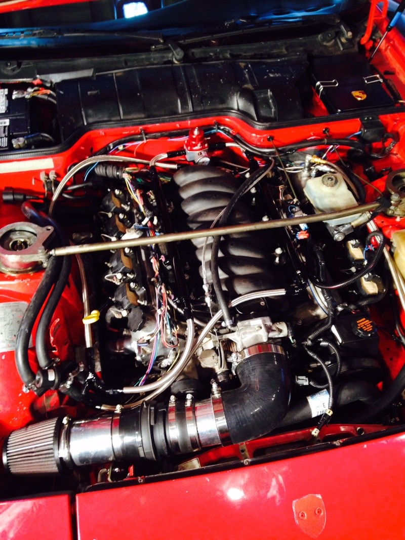

maybe post a picture of your master cylinder in the car, might be helpful.

Sharkey, thanks for the reply. I think you've nailed it. I bet that's what is happening. Oddly enough, when I first installed the system, I bled the brakes twice with the "overnight" loss of pedal feel both time. When I bench bleed the master I thought it was fixed, but over time it softened up again. However, this last time I bled the brakes I did indeed get a few large bubbles out of the rear passenger side caliper. I'm hoping this may be the last of it. So far, so good. Attached is a pic, of my engine bay, I'll take a better one tomorrow.
