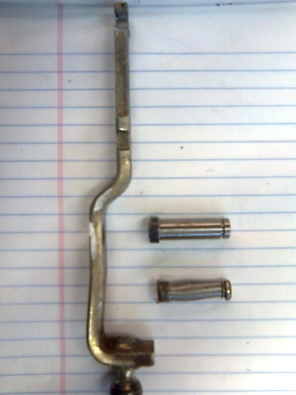

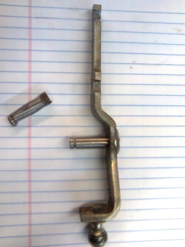

Aix, if your front shifter lever barrel is worn/football shaped it will cause this problem in 1,2 and 5,R
Once you've checked/repaired, make sure the trans lever on the trans will go into 1,2 by the lever it self to rule out any linkage problems.

Yes, the stud inside the longrod....

One way to fix, with cap head screw and thrust washers. There are other ways too.

Actuallly, if that's a pic of your shifter, it looks like yours has already been done...
