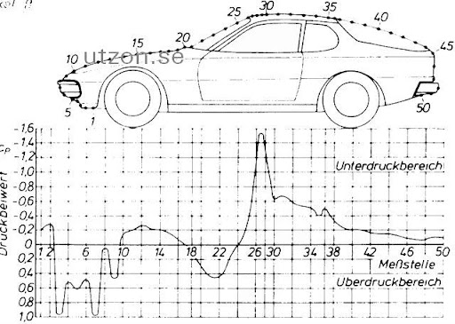

Post  Rich L. Mon Jun 18, 2012 12:20 pm
The trick in venting the hood is opening it up to a low pressure zone. Unfortunately, the base of the windshield is a high pressure zone, hence the HVAC intake being located there. The front half of the hood, basically ahead of the shock towers, is ideal for adding vents to evacuate air from the engine bay radiator and increase the pressure drop across the radiator core.
As posted before:
Controlling the water temps on the track 924-cf-diagram

Hmmm, ok, so a naca duct or reverse louvers on either side there would help...
I think I'm going to drop the car at the body shop to have them open up the front license plate area, the header panel and maybe vent the hood too...
Posts : 1393

docwyte wrote:Hmmm, ok, so a naca duct or reverse louvers on either side there would help...
Whoa, venting your header panel will only hurt the air flow through the radiator as it will cause an increase in pressure behind it. IIRC you have a 951; that means you used to have a 5 inch thick intercooler in the header panel which caused a restriction for the air flowing into the header and behind the radiator, not much air flow and therefore lower pressure behind the radiator. Now you don't have said restriction which will allow more air to flow into the the engine compartment and effectively reduce the amount of air flowing through the radiator. If it hasn't been done already, i would suggest that this area be closed off from the engine compartment.
I would block off the engine compartment, get a better pump, a high flow TS, add more radiator surface area, and then add louvres.
