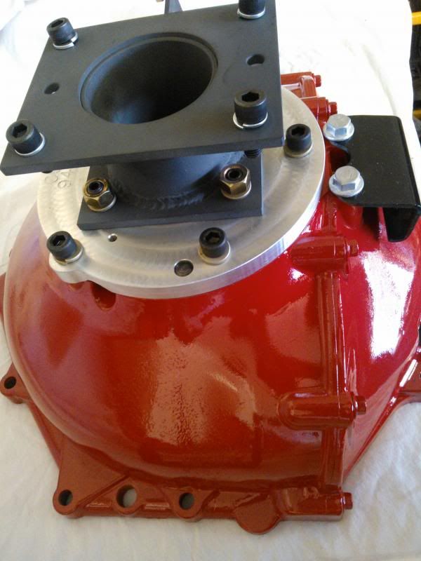

You can fab one of these up....
928 5-speed into early 944 WP_000380_zpsee8dfc6d[/URL]
928 5-speed into early 944 WP_000382_zps9e4faeed[/URL]

Another plus is the 928 TT & trans will drop right out, move rearward easily along with it' s torque tube for clutch changes and TT bearing r&r

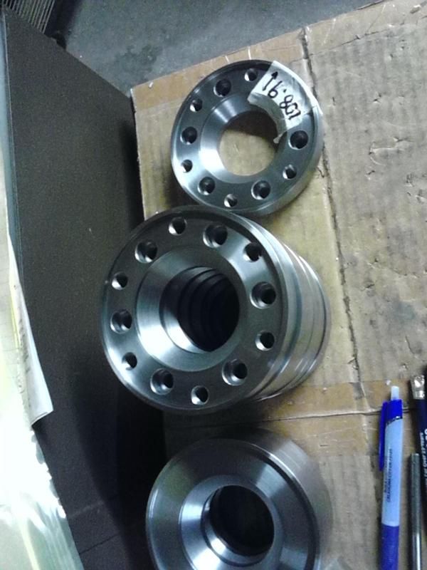

The adapter I machined and still sell above is Only for an LS engine mated to the 5-speed 928 Torque tube, so that's what you would need up front. The CV adapter I make is also for an early car or one without the ABS outer stub shaft to be clear.
The 928 5 speed shifter mechanism is Easy to mod and make it move front to aft for positioning.
Where are you located? I sent out adapters for this exact swap a year and half ago but never heard back on the swap. I would like to see some one actually complete it.928 5-speed into early 944 IMG_20150518_203751_zps6gzznwba
