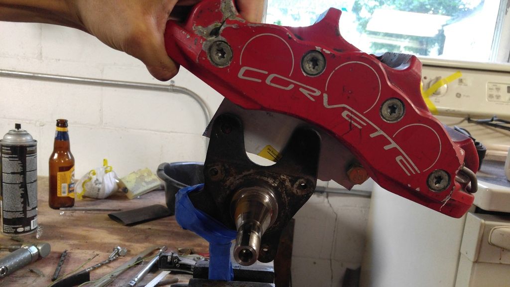

Bringing this back from the dead. Rob sent me his Z06 Caliper, and I will be making the mounting adapters. I am working on finalizing the CAD model I have before sending it out to be machined. I will be doing these for 350mm Cayenne rotors using an 87 NA spindle. In the future I might do one for the turbo spindle as well, if I ever get my hands on one.
Material, I'm thinking 1/2" steel like Rob's were. Pricewise, I'm going to aim for $100 for two powdercoated adapters, with four 10.9 M12x1.5x25 cap head bolts, four M14x2x35 Head head bolts, and four 2mm M14 shims to center the caliper on the rotor. I have 18" Turbo Twist wheels for fitment verification.
Let me know if you are interested, I will try and get these done shortly.

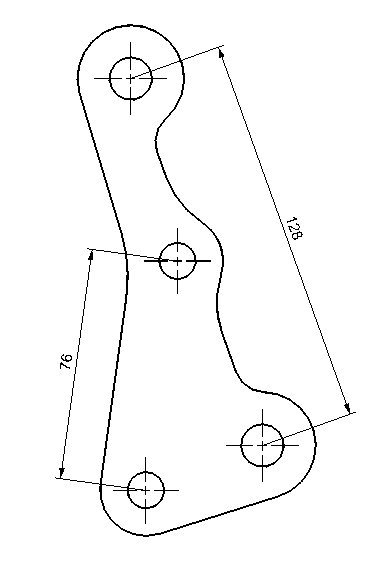

Ok, I believe I have a finished concept. Is anyone interested in a pair of adapters?
This drawing just has the critical dimensions. The part is slightly rotated upward on the spindle.

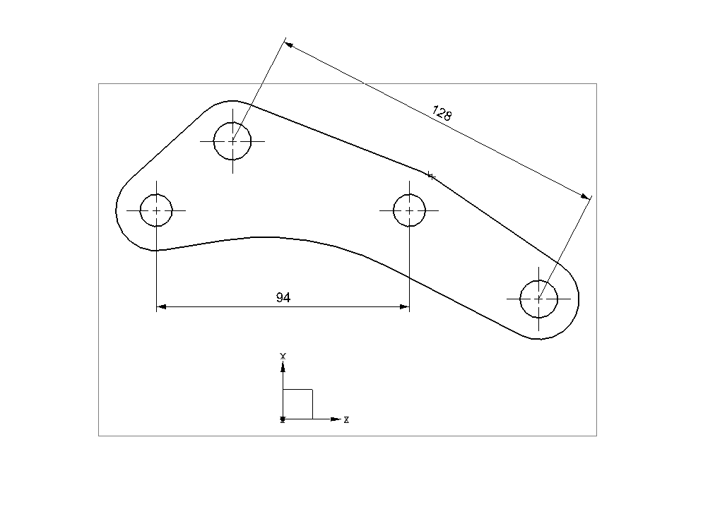

I measured one of my 87 Turbo spindles, non S, and the measurement was 94mm. I will also try to get a measurement from a 86 Turbo spindle but I'm guessing that will also be 94mm.
If you ever made the adapters for the turbo spindle I would definitely buy a set.

I can make a CAD model and go from there. I'd like to be able to offer them for the Turbo spindles as well. I'll send you a PM.

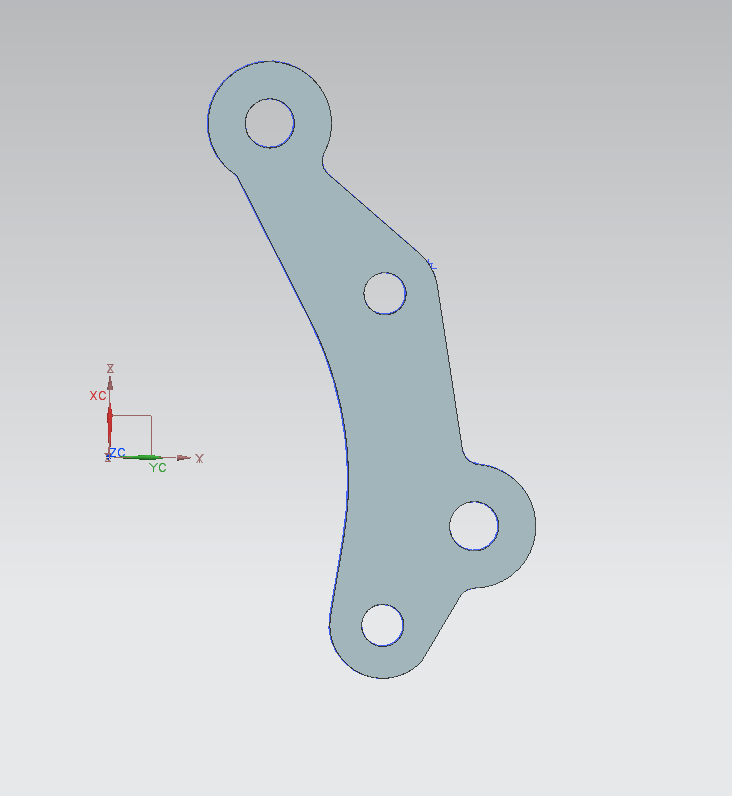

I believe I have a working model for the 951 Spindles. The only concern is the upper mounting bolt on the 951 spindle. I think it will interfere with the brake line too much. Counter boring the hole and using a flat head bolt would solve this. However, I can't find any in M12x1.5. I'll keep searching and see what I can find. This same bolt would probably be useful for the 944 adapter as well.
EDIT: No luck finding the flat head bolt with fine threads unfortunately. What might work is counter boring the hole for a regular socket head bolt. I believe with a banjo bolt, it will clear for the turbo spindles.

I realized I missed a feature on the caliper in my last drawing. This will work better for the turbos.
