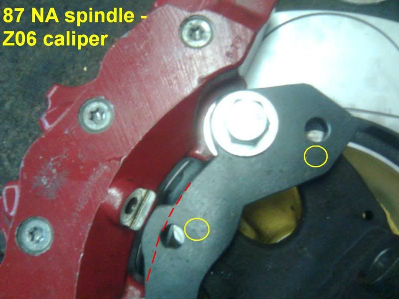

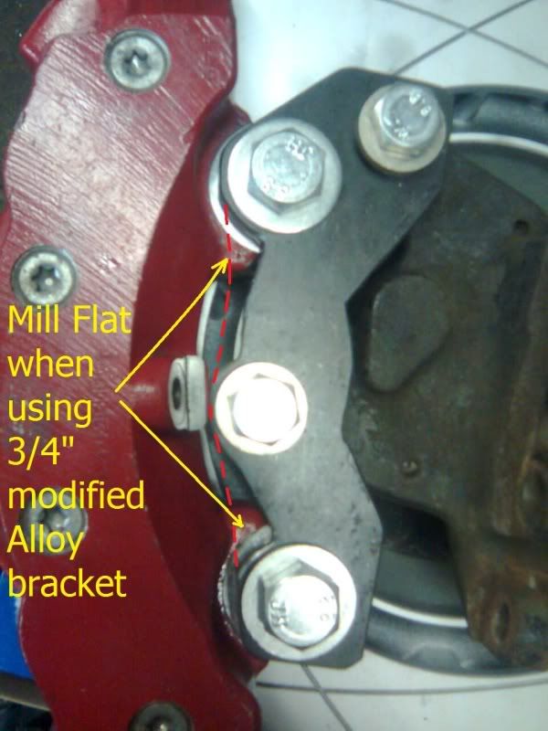

I used Schue's alloy prototype to make the adapters out of 1/2" thick 4140 cold-rolled steel on the hand mill..... Everything fits beautifully. Not in the pic, the backside, where adapter mates to spindle ears is milled 0.08 and this pic shows where the caliper needs to be milled when an alloy adapter is made.... Now I have to hand mill the other mirror side adapter santa

Post  Schuepbach Fri Dec 23, 2011 10:04 pm
looks great Rob!!! This will be a great xmas present Very Happy
