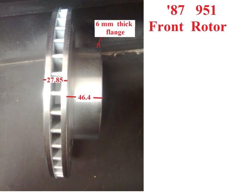

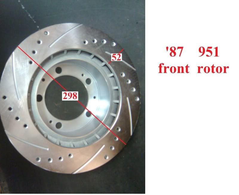

Gonna kick this mod off the right way. After alot of requests I'm going to build adapters to put on the Turbo Brembo calipers and 87-up Turbo 298 x 28mm rotors on the late NA spindles.....

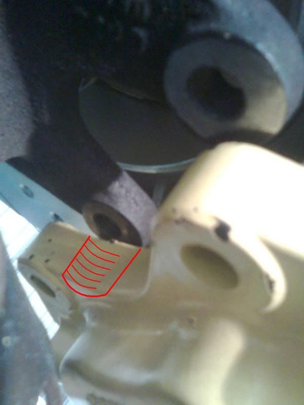

Post  xschop on Wed Jan 26, 2011 4:00 pm
Was at the shop last night trying to figure a good bracket design and took a pic of the situation. Looks like a 1/2" thick steel plate would have to go across the back/flycut side of the spindle ears and steel offset "barrels" welded to it or CNC'd for the caliper bolts to thread into.You would also have to trim the 951 caliper here some to clear the thru-bolt.....
Bad News is I won't be building anything that requires grinding/modding....bolt on is where it's at....
