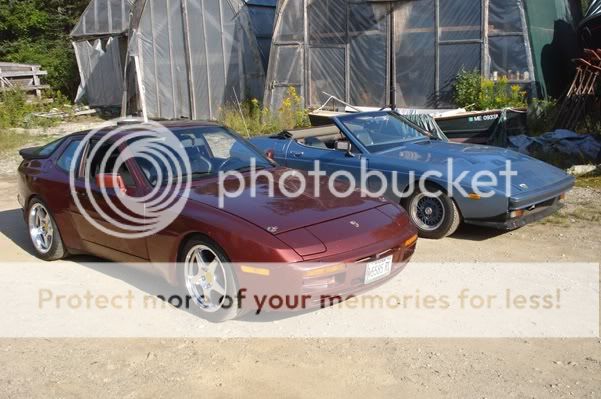

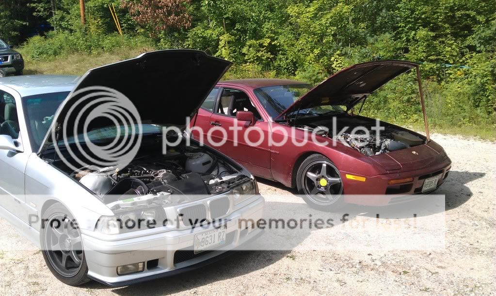

It's been a long time since I posted here, but I couldn't have finished my conversion if it wasn't for you guys. I actually didn't post any pictures or anything since I "finished" so I put a couple in this post. (You probably have to look at the picture outside of the post because the they get cut off in the forum and I don't know how to fix that)
