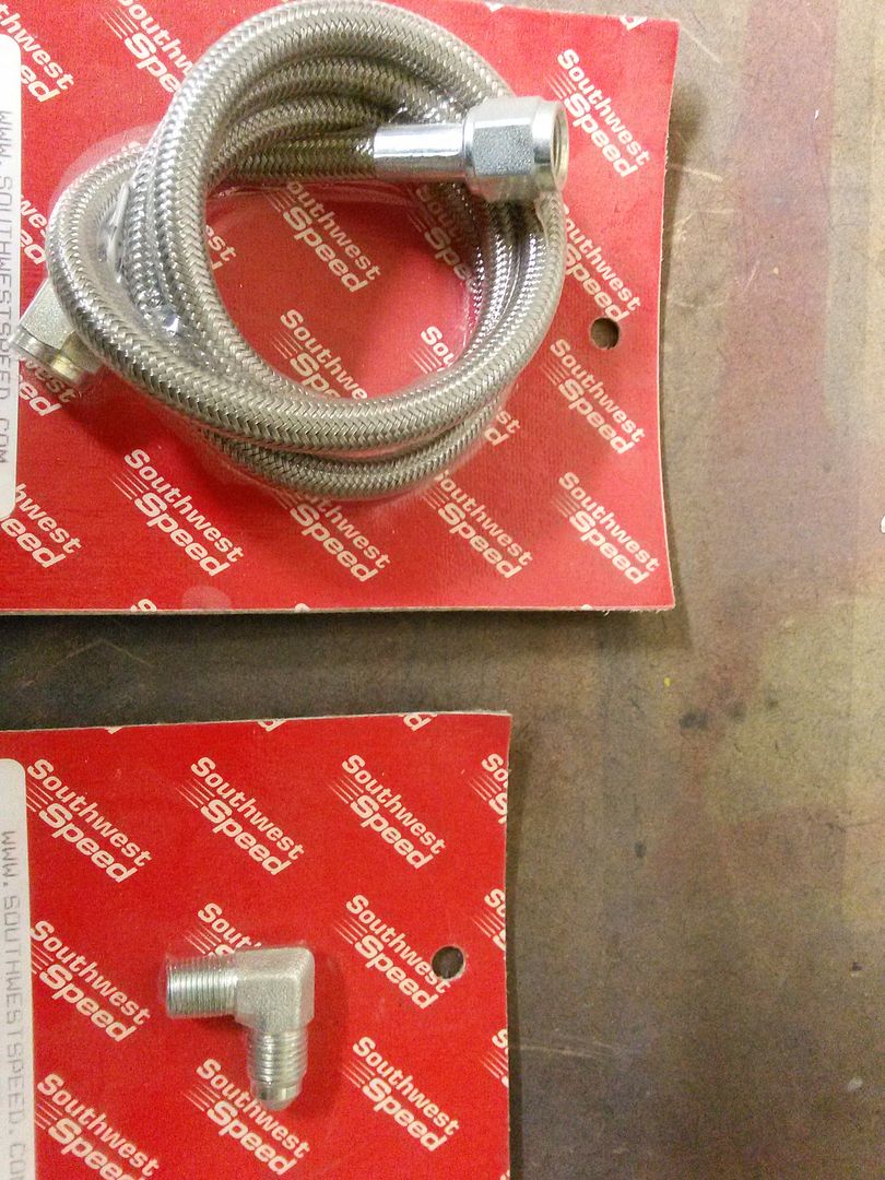

Post  xschop Tue Feb 16, 2016 8:25 pm
I have made many, but don't any more as I posted the adapters dimensions here.
I do have a couple spare npt adapters and 30" SS line if you're interested. $30 shipped us-48
