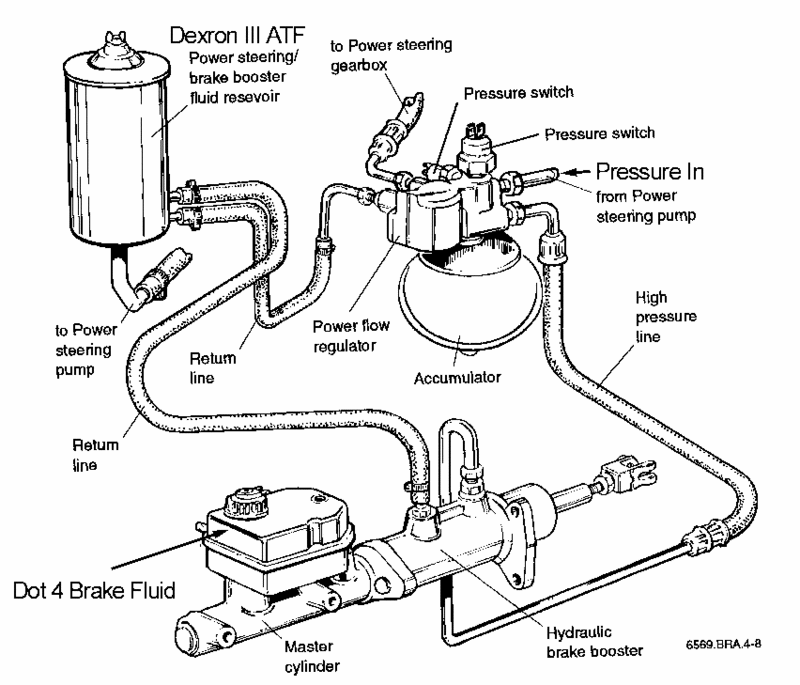

Post  Tetzuoe Mon Jun 22, 2009 11:33 am
I ran across a diagram while looking for accumulators:
BOOSTER DELETE - Page 2 Image_10
