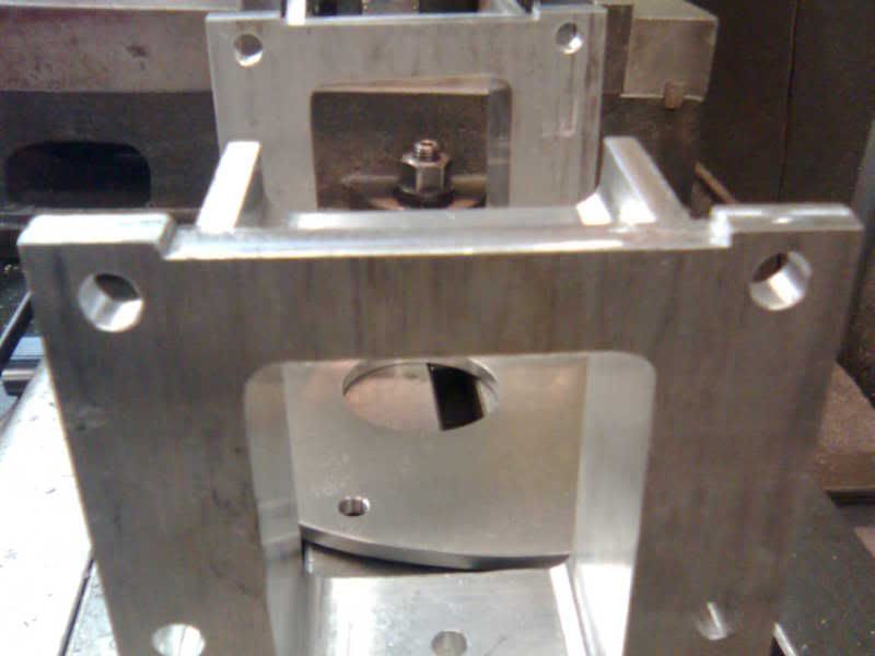

I just finished re-milling these last 2 firewall housings for the Tilton 72-610 (72-650 obsolete). I also had them welded where there is more left to right adjustment with washers between the bracket and dual mount because these firewalls to pedals are off from each other it seams....damn Germans.

That looks to be a copy of Tilton's 72-650. So it will fit the Dual mount that I designed. I had to machine off 1/2" from the end of the firewall housing mount because the available 72-610 has two of the stud bosses protruding unlike the 72-650. Looks like that Wilwood also doesn't have the stud protrusions because it is 60* as well (it would mount up)

I had enough material to make another one and had it Tig welded. So these are the last 2 period. $225 shipped in the U.S. only. Sorry. My Gov't has made it miserable to ship outside the U.S. LOL
That inexpensive Ebay Wilwood mount will fit now just like the Tilton 72-610..... And of course if you can still find a Tilton 72-650 it will still bolt right up. I left enough material where you can drill a 10mm hole for a heim joint brace like I did on mine also.....

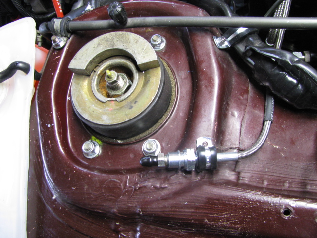

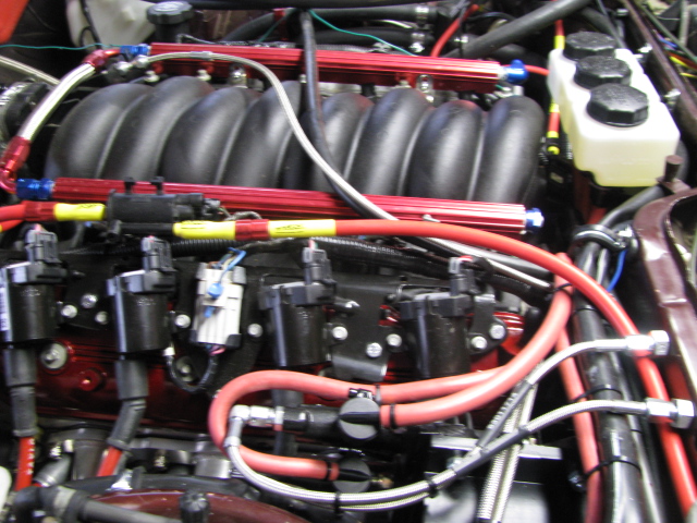

Finished M/Cs and Hydraulics
Post  87-944S on Sun Jan 02, 2011 6:44 pm
Well, I'm back at working on the car, I bought a propane heater that heats up my tiny garage rather quickly. Here's some pics of the finished plumbing for the brake and clutch M/Cs. The empty reservoir is for the rear brakes, I'll do those soon.
And the speed bleeder for the clutch
The rear brake SS braided line will go into the interior to an adjustable bias valve mounted under the dash.

Post  Arthropraxis on Thu Jan 13, 2011 8:21 pm
You are running truck coils, right? I tried to mount mine with regular LS1 coils and the coils would have to be relocated.
Posts : 1103
Re: Tilton Dual MC Setup
Post  87-944S on Thu Jan 13, 2011 8:31 pm
Yes, those are the truck coils, they mount a bit further up on the valve cover.
