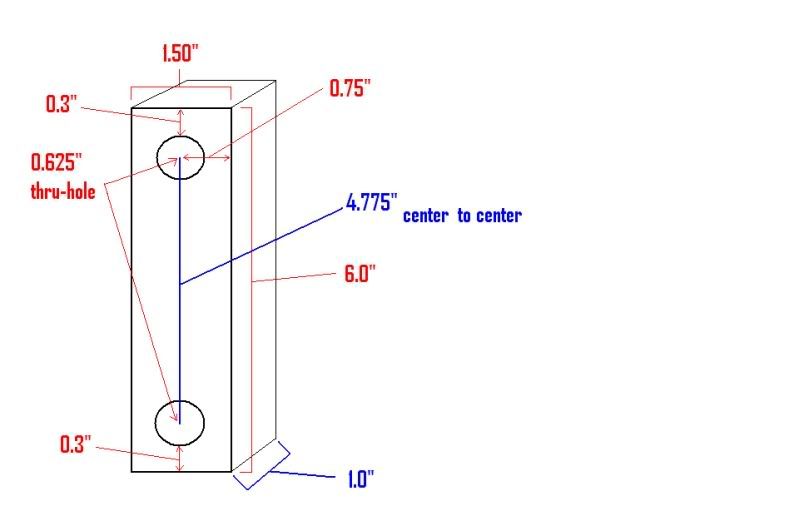

Hey,
For some reason (don't know why I didn't notice this before) I've been seeing a lot of posts that have a lowered crossmember mentioned??? I didn't know that this was necessary for the LS1 conversion? Any links or details would be appreciated! Sorry if this is a really obvious question. Also, I've got to finish reading the enormous thread on Headers. I originally thought that the Sanderson's worked right out of the box.... hmmm
Luke

Post  944-LT1 on Mon Jan 18, 2010 2:26 am
The crossmember needs to be dropped 1/2" due to hood clearance issues. Thats the only reason that I know of. The sanderson headers are for LT and gen1 heads and do not fit the LS engines especially due to the exhaust port configurations.

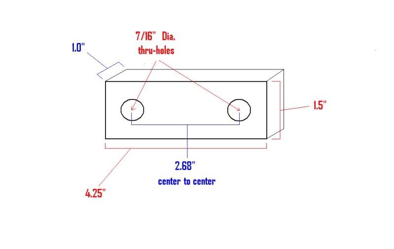

Post  944-LT1 on Mon Jan 18, 2010 1:54 pm
Sanderson does make LS headers, but they currently do not make a set that works with the LS 944 conversion.
For the crossmember spacers, I simply bought some aluminum stock from mcmastercarr.com PN# 8975K423 which is a 36" long, 1-1/2" wide by 1/2" thick piece of 6061 aluminum. Cost is about 15 bucks. Then I just cut it to two pieces of 6" length and another two pieces of 4-1/2" length. Then I drilled two holes in each. It was pretty easy to do. I cant remember if theres a diagram of the spacers in the manual but should be. Otherwise, theres a few pictures floating around in this forum on where to drill the holes and how large made by Xschop.

Post  Luke714 on Mon Jan 18, 2010 10:09 pm
gt1scca wrote:From the LSX Shopping List:
Modified Hooker 2312 or Sanderson...
(The "or" means both will have to be modified.)
Poorly worded, my apologies.
oh, ok. no prob, that's why I'm spending all winter collecting parts and doing research. Razz
Thanks for the drawings, that's awesome. I'll have to look later but I don't think there were drawings (could be wrong) but there was a mention of crossmember spacers. Wasn't really sure what was meant by them, now I know. I love Mcmaster Carr!! They've saved my butt a couple of times, ordered all the parts before 5:00 the night before, spent all night machining, and then installed the parts that arrived in the morning mail!

Post  gt1scca on Sat Jan 23, 2010 8:35 pm
1/2" Spacer drawings are in the manual.
The RH LT1 mounts are too tall...Ask 944-LT1.
The uprights drawing here, in the Wiki, and the Manual will work on the SBC / LT1 / LS engines.
Proven to work on the LS engines with CarShop, Inc. set-back plates and "short" style urethane motor mounts. The el-cheapo rubber mounts made by DEA Products will NOT work, due to the design of the backing plate.
The correct uprights and mounts are also listed at 944v8s.com and TexasPerformanceConcepts.com.

Post  stuart f. wright on Sun Jan 24, 2010 5:25 pm
does the spacers require bolts 1/2 inch longer

Post  Luke714 on Sun Jan 24, 2010 11:15 pm
oh, you're right gt1scca. Sorry, now it looks like I didn't read the manual. Those don't look like they'll take too long to knock out on the mill. I was also wondering if anyone has come up with a rough list of hardware that is needed. My local hardware store doesn't carry much in grade 8 or metric, so I'll be ordering ahead of time from Mcmaster. If not I guess I'll order as I go along. I'm trying to do all of the planning away from the car while I'm at school, so it makes it hard. Are there some specific hard to find bolts?
