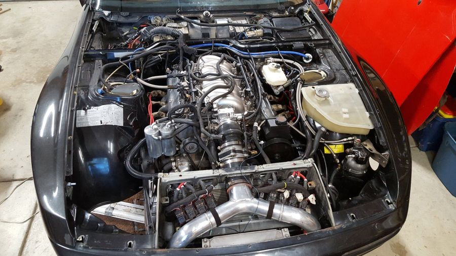

Post  87944turbo on Tue Jun 25, 2019 9:09 am
I just cut the hood latch out and went with AeroCatch latches.
Intake Piping For Very Tight Clearances? 80-ls_swap_10_aeab95cd7d18e7e1868b366518f5676a0f8ff588
https://www.aerocatch.com/
I had to cut the bracing out in the area of the throttle body, but otherwise closes fine w/out using spacers on the crossmember.
