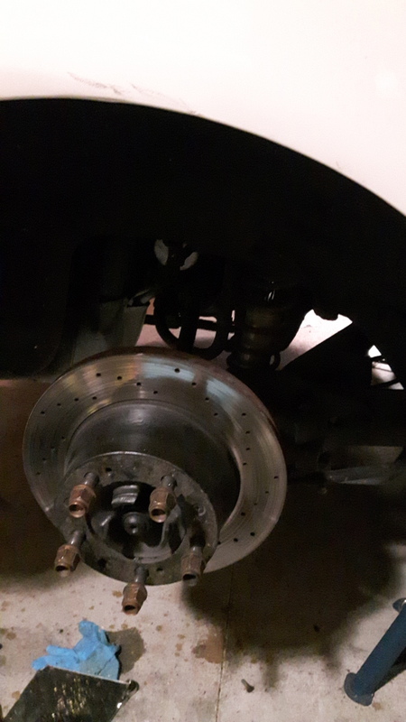

I have needed some rear calipers to match my Cayenne fronts (which are awesome, by the way), and I believe this is the best way.  The calipers are ordinary Boxster calipers.  I paid $70 on eBay, but there are cheaper options at local scrapyards. I simply made these on my Clausing drill press with layout fluid and a nice 6" rule.  I can post dimensions if anyone is interested, or I'd be happy to make them.  These pictures are with NA rotors, but the calipers would be best fitted with turbo rotors.  These rotors are junk anyway, so I plan to get Turbo rotors soon.
The bolts are not the ones I would use, they were just what I have around.  My stock of M12 bolts is lacking... And yes, the caliper is upside down, it's just this side of the car was more available for fitting and I only have one caliper so far.

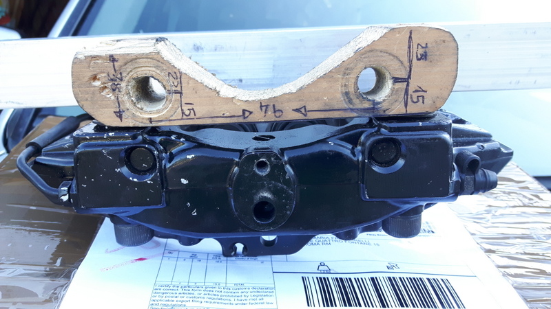

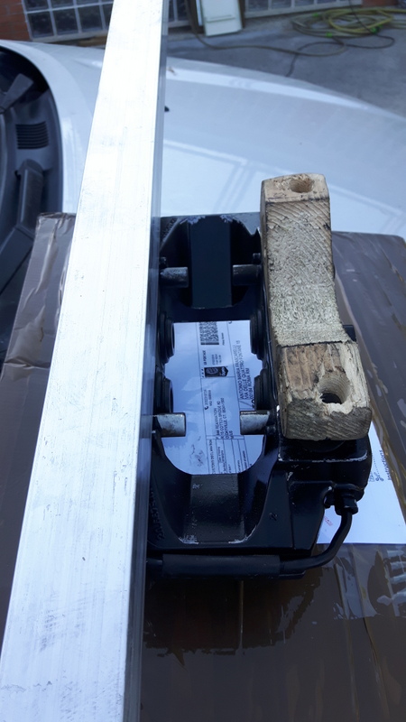

HERE THE PROTOTYPE IN WOOD WITH THE BAR ALU 6082 4X4 CM THE DEFINITIVE SHAPE MUST BE THIS AT LEAST WITH A TURBO S WITH ABS AND OPTIONAL 030. THE MEASUREMENTS ARE NOT DEFINITIVE MISSING SOME MM

You have Turbo S M030 spindles? Those are radial mount not axial mount.
