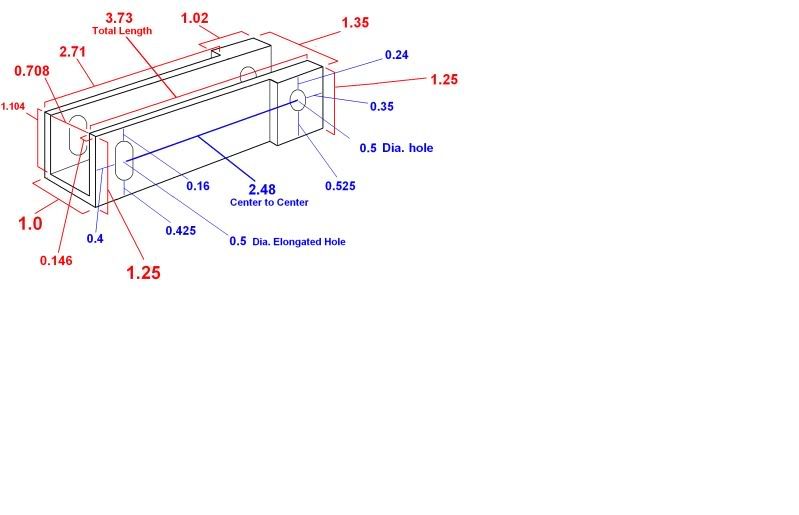

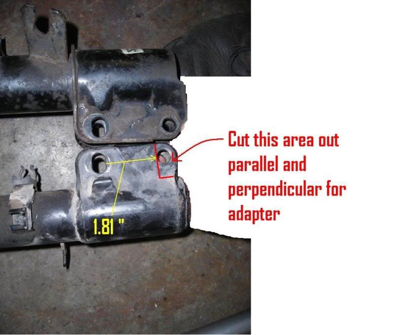

This is the proper way to convert an Early strut to accept Late spindles and retain correct geometry....
I've seen some sh*tty attempts at this conversion with scary tactics...So I devised my own method...
First disassemble the Early strut and set the end up on a mill and cut the edge perpendicular to the strut housing right at the lower stationary bolt hole edge...I measured 3 different ones at 1.81"
Mill out some adapters with that 1.81" Dimension and that convert from the 20mm spindle mount width to the new 18mm width for the late spindles. The new spreadwidth Centers are now 63mm and this is even a stronger design....
I machined mine to fit perfectly in the slotted camber hole of the Early strut outter clamp so there is no shoddy upper hole modding to do.....
Make sure everything fits before crackin' ot the welder....
Weld along side the 1.81" Dimension and sides, and then the top and bottom just like the factory did. This will be even stronger than the way the German guy did it....
Don't half-a** it, put some pretty paint back on there...
Works like a charm.....The Main Point of the story is they rebuild with the simple inserts and Early Koni inserts just using the screw cap

2.48" (63mm) are the C2C on LATE spindles
2.28" (58mm) are the C2C on Early spindles
I never made an adapter to put Early spindles on any offset. This reminds me I have to build another set. I use 300lb Black Magic springs for the V8 swap from Southwest speed. My inexpensive KYB G2's are holding strong too.

got it...so 1.8" is not C2C.
thank you!
