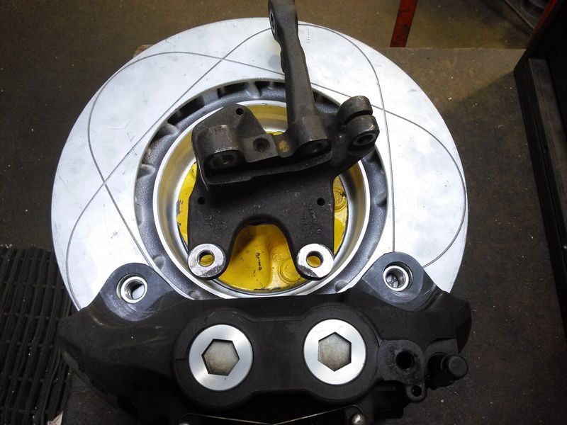

I need a show of hands from anyone that would like a set of adapters to install Larger LS460 calipers and Cayenne 330mm rotors on EITHER 951 spindles or 87-up NA spindles.
Price will be $225 shipped US-48 and will come with Cayenne rotor centering rings.
These are 4-piston (43mm x 2) same as LS430 but larger pads and bodies to fit larger rotors.LS-460 Big Brake kit IMG_20150504_101602_zpsleshpfbz

I made a couple sets of these adapters on a hand mill. I didnt get enough interest in them to make a cnc run.
These are VERY good brake calipers as they have the same piston sizes as LS430 calipers but are larger and take a larger pad and can accept either a 330mm or 350mm rotor.
The axial mounts allow for adapters that fit the NA or 951 spindles as well....

Look no further than pic above. These are massive monoblocks and can be found at salvage. I may have located another pair locally. Toyota/Lexus salvage usually have the newer models from insurance buyouts.
