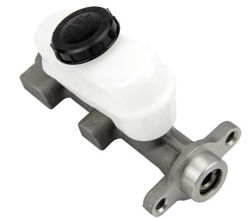

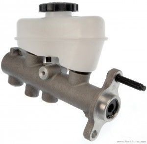

Hmmmmm so the MC from a 94-95 cobra is 15/16 like the front bore of the 944... and it looks like it bolts onto the hydroboost form 99-04 mustang except for it will be clocked differently. Will there be a problem with the hydroboost interacting with the cobra MC since it's bore is 1/16" smaller?

99-04 Mustang MC:
94-95 Cobra MC:
