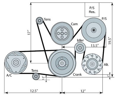

And here's a linked pic of the layout and dimensions:
The problem with the CTS-V kit is that in addition to the kit, you need a couple more parts. At a minimum, a CTS-V water pump and harmonic balancer. Adding these parts drive the cost of this solution up well past $1,000. Since we're talking 4.8 and 5.3 swaps, that seems to go against the budget minded nature of some of these projects.
