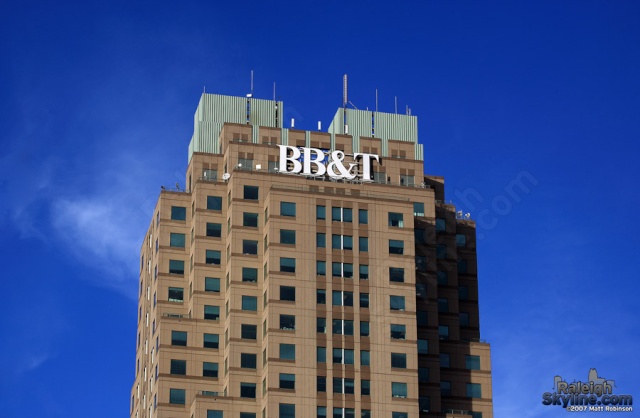

Post  gt1scca Tue Jul 07, 2009 10:09 pm
Yea...
Those are used in the commercial sign business, in .090" & .125" aluminum, in up to 14' high / 500 lb. letters (i.e. BB&T, Raleigh, NC; Lowe's Home Improvement Center; Wal+Mart; etc.).
No problems if installed properly...
BOOSTER DELETE - Page 4 Bbt_ra10
(The Raleigh BB&T letters also featured 2000+ LEDs...)
