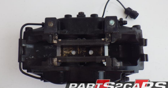

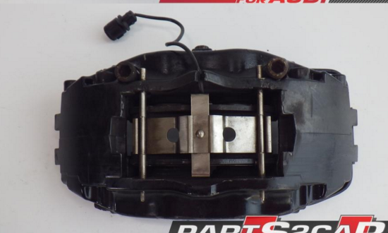

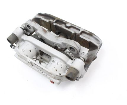

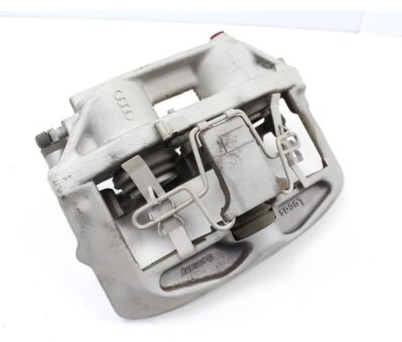

Have to be D2 S8 2001-2003. D3 Calipers are floating style, totally different.

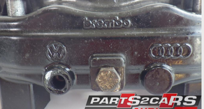

I think i've figured it out. For the A8 and the S8 they had a 323mm rotor and a 345mm rotor. The 323mm caliper is a floating type and looks like this. You'll notice it's a Lucas caliper.
XSchop "Bigger Blacks" on Cayenne 330mm rotor adapters - Page 2 323%20caliper_zpsgah1doga
XSchop "Bigger Blacks" on Cayenne 330mm rotor adapters - Page 2 323%20caliper2_zpswzklljpk
The caliper Rob uses (correct me if I'm wrong Rob) is from the 345mm rotor vehicle. It's a brembo caliper and looks like this:
XSchop "Bigger Blacks" on Cayenne 330mm rotor adapters - Page 2 345%20caliper_zpsa54warde
XSchop "Bigger Blacks" on Cayenne 330mm rotor adapters - Page 2 345%20caliper%202_zpskm758ytg
XSchop "Bigger Blacks" on Cayenne 330mm rotor adapters - Page 2 345%20caliper%203_zpse8lm8o5q
Be careful when you shop. I've went to two places that thought they had the 345mm caliper but had the Lucas 323mm caliper.

Post  xschop Tue Dec 22, 2015 12:44 pm
That's it. It's unmistakeable by its extended radial mount bases.
Brembo just took a Ferrari caliper mold and added length to the mount bases.
