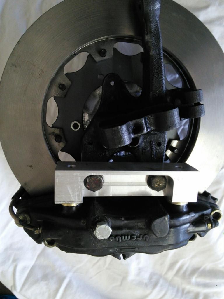

I did clearance the adapters for the factory hex-head bolt and socket to fit.....

Late NA hubs/spindles bolt right up. You get an extra 3mm wheel clearance per side as well since the M030 hubs have the extra 3mm hub height....No more expensive hubs /spindles to track down or replace if bearing lands get worn either. To put them on an early car (pre '87) you can either put on a late suspension or simply mod your early strut.

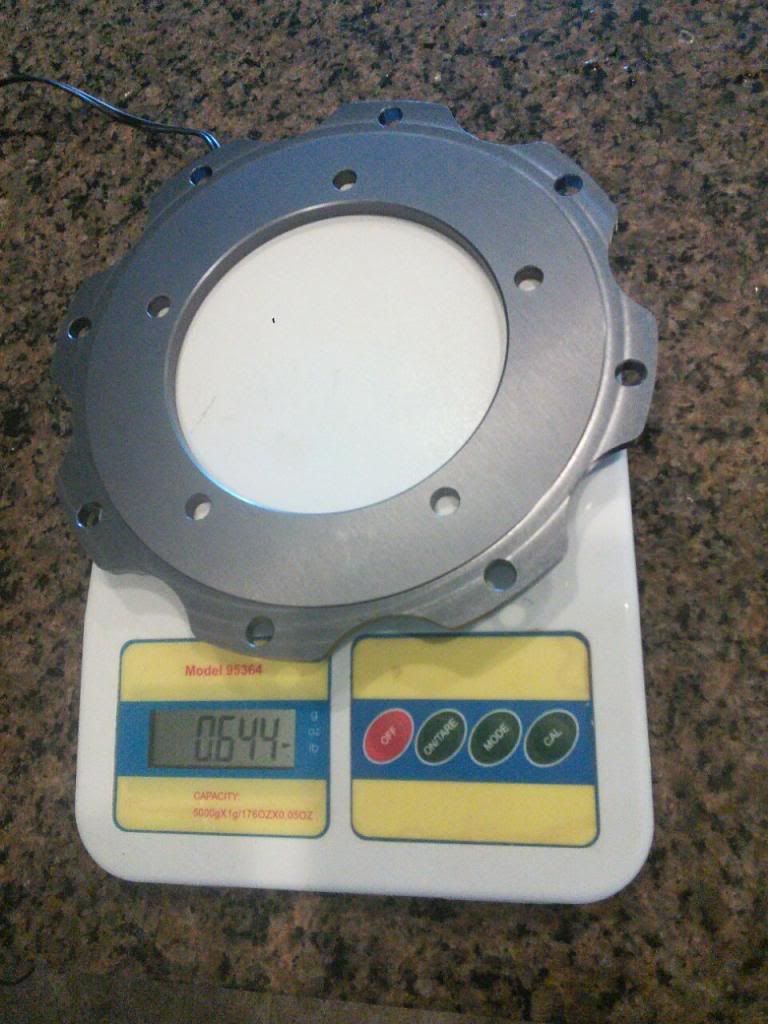

I am working on the details to put the M030 calipers on an EARLY NA car without needing custom billet hubs. I purchased an off-the-shelf Coleman rotor hat and 2-piece rotor to do the mock-up. They are Bigger and Lighter than M030 rotors at 309 x 32mm and 13.5 lbs.....

Instead of machining a whole new adapter, I added 3mm spacers between adapter and caliper to make up for the Coleman rotor diameter difference.... The axial dimension stays the same...Works perfect, no more changing suspension, hubs/spindles....Win Win.
