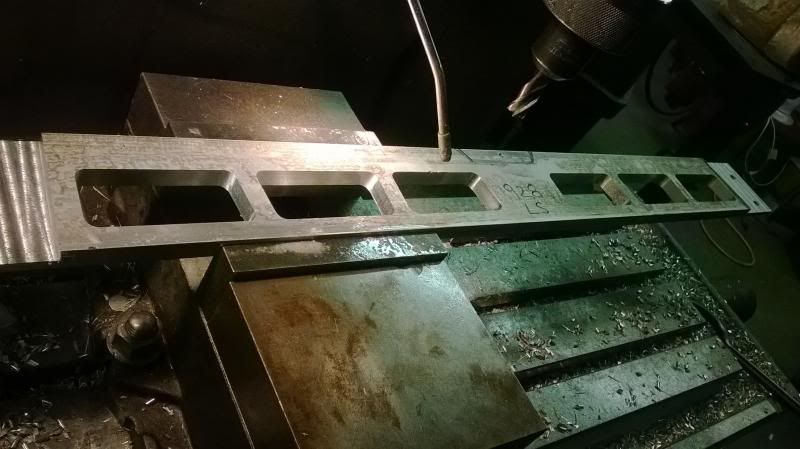

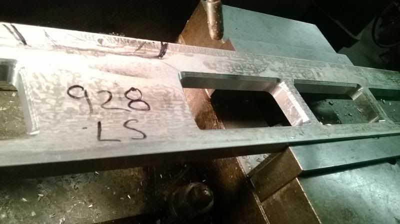

skywalker01- Posts : 477
Join date : 2009-07-22
Age : 60
Re: A-Arm Brace
Not taking any chances with my latest 928-LS hybrid.... getting a mega strong tower brace.....
