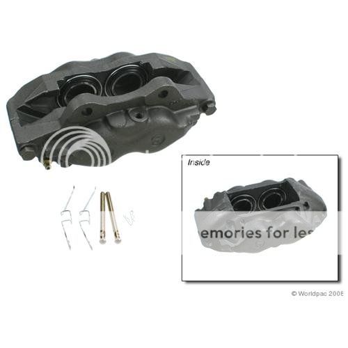

So I found out that 96 Jaguar Xjs calipers that came on the 6cyl and v12 would fit on the early offset NA cars .By ovaling out the mounting holes just a little it is a direct fit and the fit around the rotor is good.I am also able to get some EBC yellow pads for these calipers for a good price (50$ each  new caliper plus 100$ for the pads) .Do you guys think this will suffice for a street/weekend track car (L33 swapped) with the stock rotor size? I would probably just run the turbo rears for the back.

Good find, Just check the piston size compared to the Turbo calipers. Looks to be real close. Pictures of the install?

Found these here.
Not my pictures.
jaguar xjs caliper painted with the Porsche decal
https://2img.net/r/ihimg/photo/my-images/37/jagcaliper.jpg/
Install on spindle
https://2img.net/r/ihimg/photo/my-images/202/mountedonspindleassy.jpg/
Looks decent for such a cheap price.
