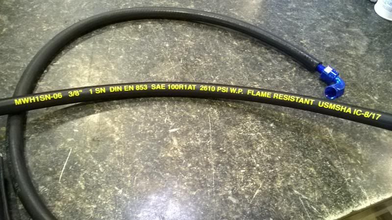

Post  xschop on Wed May 21, 2014 12:03 pm
Make sure you guys are having high pressure lines made for ATM fluid resistance. The ebay compression fittings are good for fuel pressures (60 psi) but not PS pump pressures (800-1200 psi), especially when turning lock-to-lock....
Re: Hydroboost Parts List
Post  haroldk on Wed May 21, 2014 4:17 pm
I had my hoses made at Pirtek because I knew they did good work, but Discount Hydraulic has started doing custom hose assemblies and it looks like it's about 1/3 what Pirtek charged me. Just another possible option.

Post  Lemming on Fri May 30, 2014 8:05 am
Question:  I'm not running power steering, can I get away with a Chevy power steering pump and no cooling lines with the mustang hydroboost?
Does this setup look correct?
