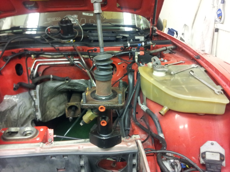

Hi
I am new to the forum and
am about to mount a LS1 / 6 engine from camaro ss 2002
the porsche 944 s2
I have one or more issues with the bracket for the brake servo.
Can I use it with audi100 1989 hydro booster
http://www.jimellisaudiparts.com/showAssembly.aspx?ukey_assembly=749727&ukey_make=1081
sorry for my bad English
best rgds
Pierre
KillzzMe
Posts : 2
Join date : 2011-02-26
Re: Audi 100 hydrobooster
Post  Arthropraxis on Sun Dec 30, 2012 5:30 pm
The base plate from the stock vacuum booster won't fit. It will contact the drivers side head.
