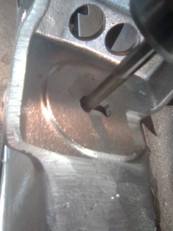

Post  xschop Wed Nov 28, 2012 10:27 am
If you slot the X-member at the uprights then no offset adapter is needed when the Supra mounts themselves are offset from the factory X-member mount holes...My $.03
wow 19mm....The LS mounts are 1/2" bolts/nuts.

Post  beario Wed Nov 28, 2012 10:30 am
lol...sorry i am lost to what that actually means...picture??
