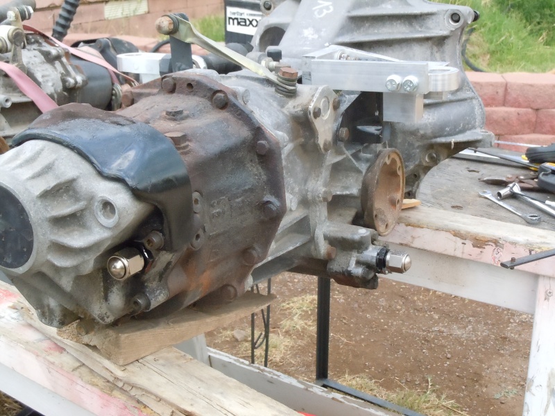

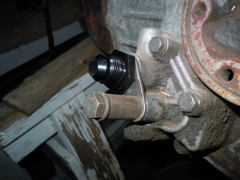

I was thinking along the same line about getting rid of the stock tranny cooler for something more appealing and this is what I saw and did.
I purchased a turbo trans with the Evil or Very Mad cooler.
I went to the hardware store and got two natural gas brass fittings (3/8 female NPT and the male side ?? I can't remember Rolling Eyes , sorry) that came close to the ID of the cooler line ID with enough material OD male thread end to turn down on a lathe with a groove up against the hex to slip into the tranny and then use a 8-AN fitting with 3/8-NPT threads (blue fittings in photo). I wasn't happy with the wall thickness where the clip fit around the brass fitting as the brass fitting didn't have the same thickness all the way to the hex at the female end leaving it on the thin side so I discarded.
I got two 8-AN flare (both sides) unions (black fittings in photo) from Summit and turned downwd one side with a groove at the hex area and walla cheers . The 8-AN fittings provide enough material to shave off and the ID is the same through out.
end results....I have not progrossed in this area at this time with any cooler so I capped the fittings.
The "O" rings I'm sure can be obtained from auto parts stores, AN-fittings from Summit, Jegs, etc.., and the reatianer clips I don't know. I'm not a machinist but I am learning to make washers and spacers and need to redo one of the fittings as it is not as tight as I think it needs to be.
Hope this helps.

Tehone,
Thanks for the info and pics.
Do you have the actual dimension (final OD) that you shaved off the unions ?
My trans didn't have the oil cooler on it, so can't get actual measurement for the fittings (tolerance from the ID + O-ring).
Thanks.
Marc

post 951 trans cooler fittings
Post  Tehone on Wed Dec 12, 2012 8:36 pm
Marc,
The ends on the original cooler coil outside diameter measured at .622" and .624" with the groove for the retainer at .548" deep.
The difference in the two ends (aluminum, on cooler coil and tranny housing) I think came from the cooler not being supported properly and wobbled some.
I used Summit AN fittings (8-AN unions) turning the threads off and then going to .611" dia on one side of the union. Prior post, the fittings are slighlty looser than I liked from the brass fittings I had turned as the diameter on those were .622" and tight slip fit.
The ID of the 8-AN fitting is slightly larger than the oil cooler coil end ID.
The retaining groove up aganst the hex was done using a 5/32" parting tool going to a .548" dia.
I don't have a size for the "O"-ring without causing a oil slick, tranny mounted, sorry. "O"-ring slips into groove inside the tranny housing inlet / outlets.
Hope this works for you and others.
