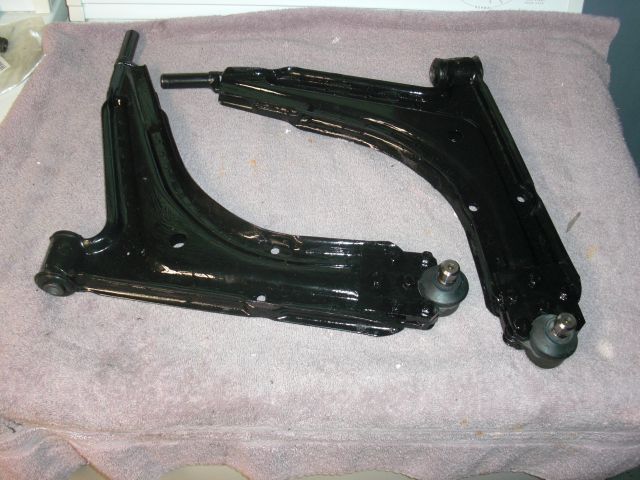

Post  simon123 Fri Sep 20, 2013 6:40 pm
After frustration with a rebuilt alloy arm and a ball joint problem I decided to fit steel control arms to my 88 948. Now I have inexpensive easily replaced ball joints. I had an alignment done today and have a question.

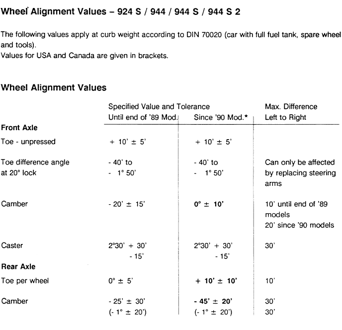

The Porsche Workshop Manual gives alignment in Degrees and minutes
( Toe is 10' +/- 5' ) (.166 degrees +/- .083 degrees)
My local alignment shop's computer rig uses Degrees and tenths of a degree
(This is not a problem as .1 of a degree is 6 minutes or vice versa).
A previous post mentions a Porsche bulletin setting toe in at 1/16"
Now i would expect Porsche to use Degrees and Minutes the same as the Workshop Manual but how do you relate 1/16" to Degrees/Minutes or Degrees/Tenths?
Anybody got a copy of the bulletin?

Post  944-LT1 Fri Sep 20, 2013 8:37 pm
Quoted from Pelican
1/16" toe in correlates to 0.15° or 0° 9' on a stock size tire diameter, so is spot on with Porsche`s published recommendations of 10' +/- 5'

Post  simon123 Fri Sep 20, 2013 8:49 pm
Thanks LT1, yes I have that data sheet from the Service Manual.
My question relates to this "Porsche bulletin" changing the toe.
My alignment guys work with degrees/Minutes[tenths] (as per your sample) and the suggested 1/16"
does not work with their electronic rig.
What did Porsche actually suggest the toe be changed to? (In degrees/minutes)
I seriously doubt a German company would have issued data in Imperial units.

Post  944-LT1 Fri Sep 20, 2013 10:14 pm
My bad. Thought you were asking for that page.
