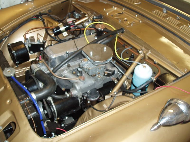

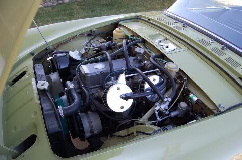

Post  msmoorenburg Tue Dec 08, 2009 7:39 am
Aww just set it up like the old Sunbeam Alpine did Shocked
Master Cyl Relocation P1010010
Master Cyl Relocation 1967_Sunbeam_Alpine_Roadster_Engine
