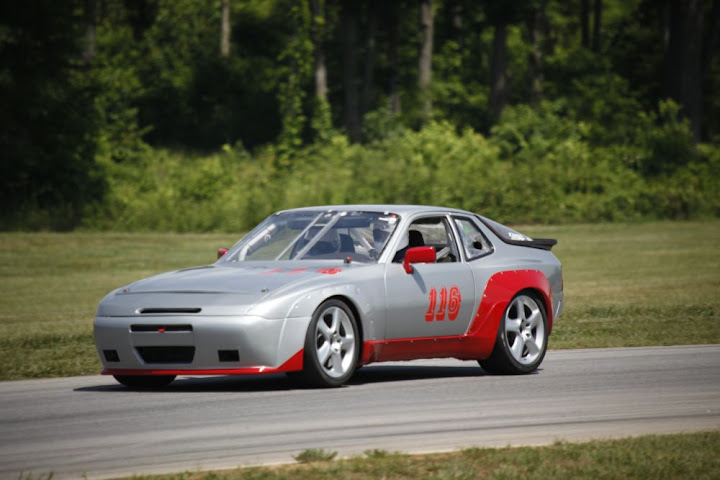

I found 2 sets (8 rims) of Cayenne knock off wheels for 900 on ebay. They are 18 x 10, ET 55, and I run 295s front and rear. You will need 2" spacers on the rear and 1" on the '86 front. No spacer is needed on the front if you change over to the '87+ offset.
As you say a body kit is required. Might want to check, but I think that 295s are as large as you should go on 10" rims.
