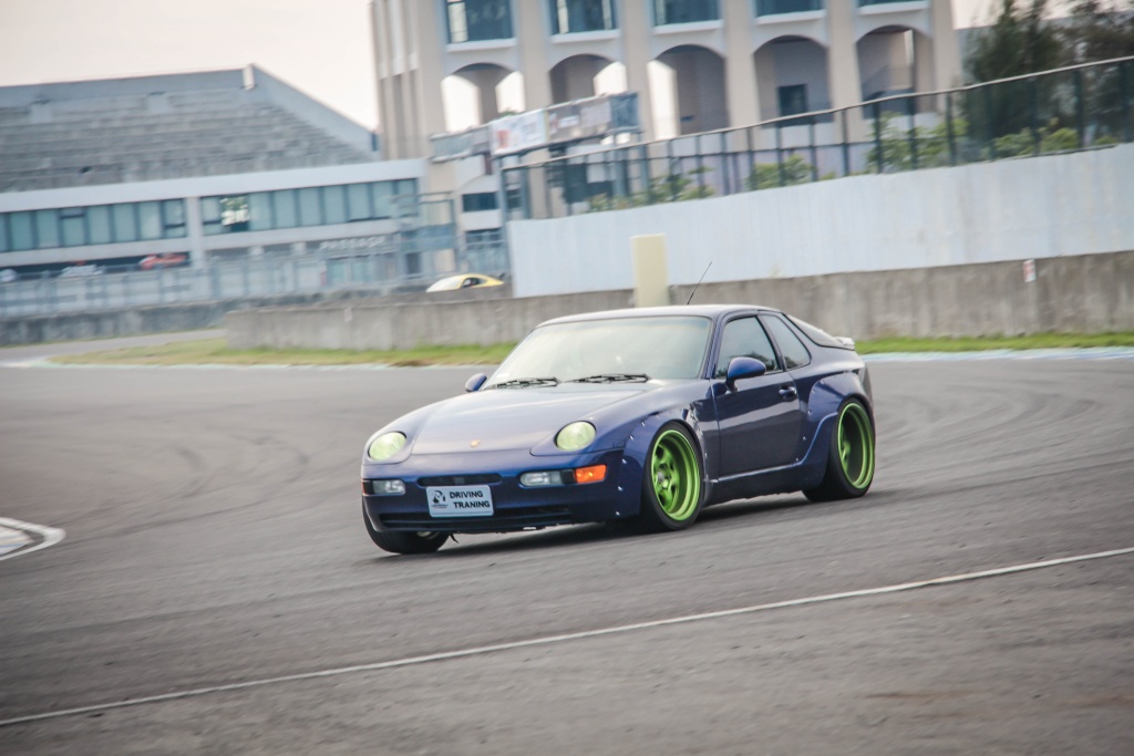

Building a LS1 968 track day project car  - Page 3 Img_7710
Some view you dont see every day. took my 968 to track this weekend, not because i want to show off Cool  . is because i get hire to be a driving coach for locoal racing school
since this is rare chance, so i ask my friend to help me take some shot of my 968 at track during my Taxi session
Building a LS1 968 track day project car  - Page 3 Img_8110
But one thing that kind da bother me is . the brake. I use bmw hydro boost on my car
and is not very consitant !!! the pedal can go up n down or with how much you turn the steering wheel
that is big NO NO for a fast lap time !!. i am still use stock LS pump will TYPE one pump help ? or
is some thing wrong on my hydro system
Last edited by Diyman25 on Sun May 25, 2014 9:42 pm; edited 1 time in total (Reason for editing : pic)

Building a LS1 968 track day project car  - Page 3 Empty Re: Building a LS1 968 track day project car
Post  kachunk on Wed Aug 13, 2014 7:18 pm
I was just checkin out Speedhunters and thought I recognized this....
http://www.speedhunters.com/2014/07/v8-swaps-theme-readers-rides/
Nice job!
kachunk
kachunk
Posts : 23
Join date : 2012-04-06
Location : MI
Post  Rich L. on Thu Aug 14, 2014 12:32 am
Interesting question on the LS1 pump versus the Turn One pump. That's not good on the inconsistent pedal feel. How does your steering feel? Others have stated the Turn One pump keeps the fluid from overheating. Do you monitor ps fluid temps?
I'm just finishing putting together a power steering system with the LS1 pump. Lemming is putting in the Mustang hydroboost system also with the LS1 pump. We'll have to both report back.
By the way, your car looks great!
Post  Rich L. on Tue Aug 19, 2014 10:02 pm
Agreed on brake feel. I have a Tilton pedal box for fully manual brakes in my 944v8 and love it. But the manual steering has been too much effort. I struggle to finish a hot lapping day.
Today I took the car out for the first time with the original power steering rack and the LS1 pump. The steering feel is consistent but very light, too light in my opinion. And the fluid heated up to 220 F in just a few quick laps. Dang!
Guess I'm spending the $$ for the Turn One pump.
