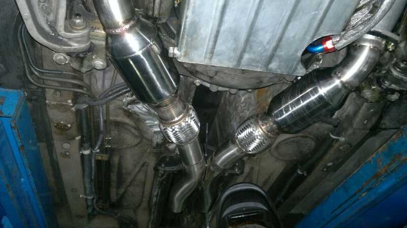

this week will target on new exhaust system
my high flow cat. i try to find out the smallest i can fit under so i dont have too much restriction
most of piping. the muffler is going to made by my application

Re: Building a LS1 968 track day project car
Post  Diyman25 on Thu Aug 30, 2012 1:08 pm
compare to my stock 968 catback now
new system should be very promising !!! either in sound or performance

Post  Diyman25 on Fri Aug 31, 2012 4:17 am
some update of the exhaust
just mocking out the posion.... so far so good
Post  Diyman25 on Mon Sep 03, 2012 9:43 pm
2.5 inch SS pipe all the way with Vband
Final part of welding
how to muffler look from the side

Post  Techno Duck on Mon Sep 03, 2012 11:28 pm
Really nice job, is that the x-pipe under the tunnel brace or just how the two exhausts were routed?

Post  Diyman25 on Tue Sep 04, 2012 2:52 am
Techno Duck wrote:Really nice job, is that the x-pipe under the tunnel brace or just how the two exhausts were routed?
Is a X pipe design
