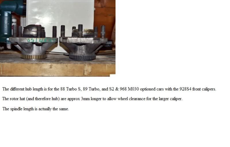

I was supposed to be getting a set of those calps to mock up on the 330mm Cayenne rotors. I've been running the Cayenne rotors under the Lexus calps for a while now Twisted Evil
The Germans made the M030 hubs 3mm taller than the NA/951 Hubs
Years ago I cheated and made a 3mm hub spacer and adapter for an NA hub/spindle. I should have recorded the dimensions.....hindsight
M030 hub on the right....

I have big blacks, 993TT rotors and Lindsey aluminum hats, the calipers are mounted on Lindsey adapters to 1994 968 spindles, basically standard turbo or S2 spindles, with the latest version of the hubs. All fit pefectly, interesting that the M030 hubs are 3mm thicker, good to know,. I got my big blacks new from Sunset Porsche, if I remember correctly, they were less than half as much a piece cheaper than Lindsey's price for big reds. Plus I wanted black calipers Smile
