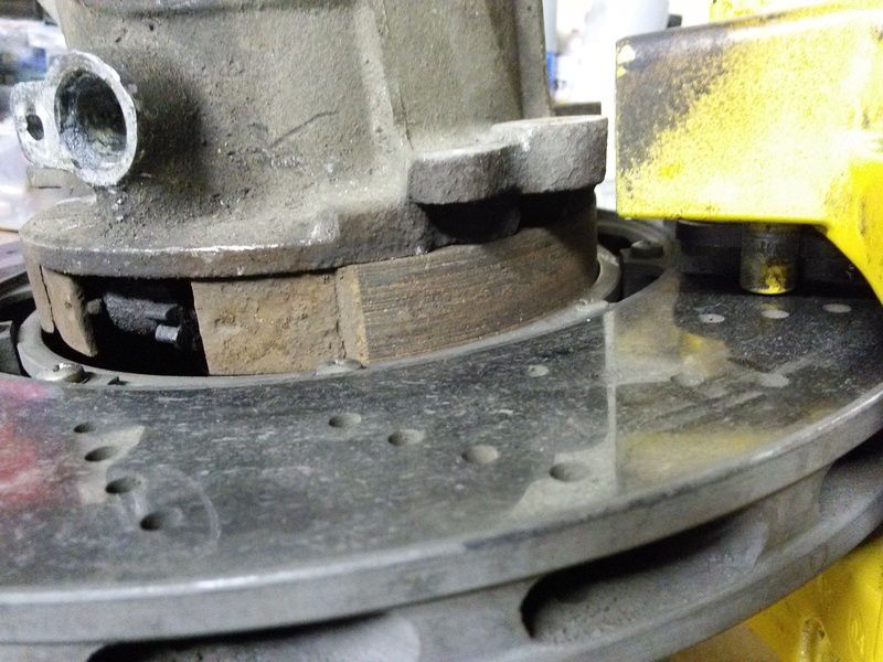

This is what we had to do to get the factory PCCB rear hats/rotors on a late car so the factory E- brake remained functional and the ABS ring is on the inner stub axle, so it remains....
Win/Win
Win/Win

I just checked my build notes and switching over to the Early outer hubs on a Late car sets the hub inwards 29.00 mm.
