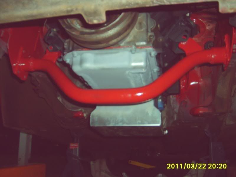

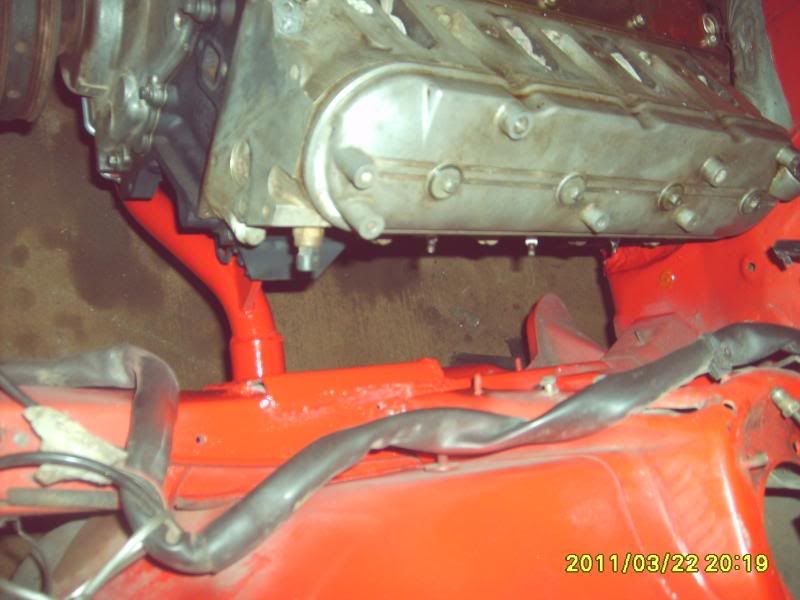

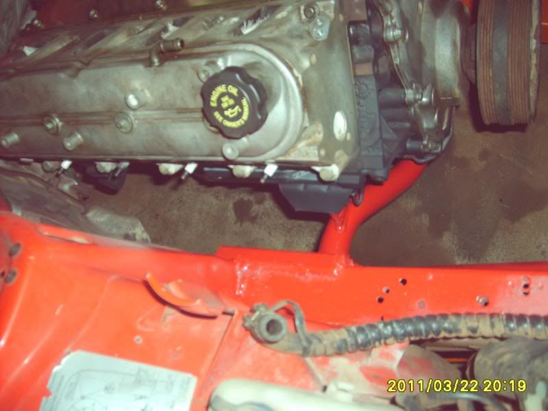

Post  xschop on Fri Jul 17, 2009 9:46 am
Yes LT1, I have the stock X-member in there now.The pics are of the engine cradle I built. From all the research/measuring I have done the stock X-member's control arm bolt holes can be drilled 1" upwards, allowing for 1 " X-member drop, then installing the tie-rod bump steer kit at 1" down at the steering knuckle.

Post  xschop on Fri Jul 17, 2009 10:35 am
I cut the passengers side to where I could bend that area over 3/8" more inch (It doesn't interfere with the truck oil pickup tube at 3/8" over) and just welded it back. The Stock truck oil pickup tube is modded after the 2nd attachment bolt using it's own body that is cut in various angles to get it to set 5.5" below the pan/engine face....works like a charm and saves 80 bucks from Moroso.
I will agree with Eric (Admin) that a tubular X-member and the stock truck pan can go in UNTOUCHED WITHOUT A HOOD MOD. However the Truck pan can go in with a small/short (@ 1") hood bubble.
EDIT..... the 1" hood mod with the truck pan would have to include a 1" X-member drop as well
