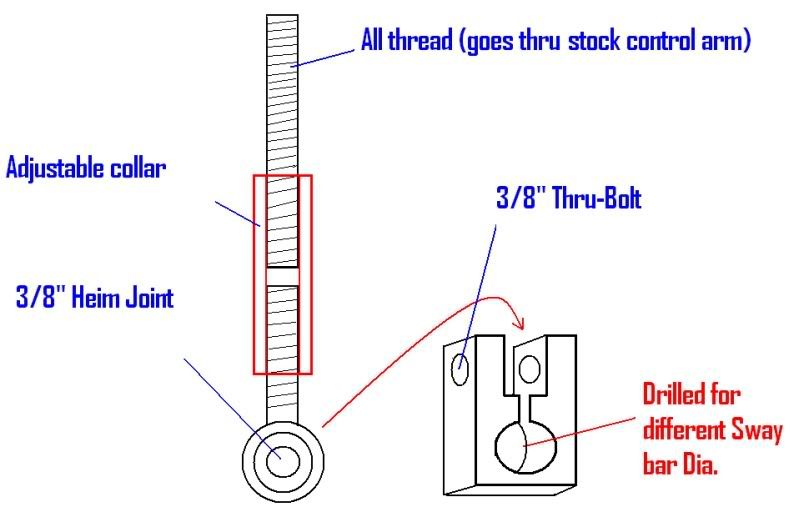

Post  xschop Tue Jul 14, 2009 12:26 pm
I've been challenged to come up with an easy Sway Bar Preload System for our cars.....
What about this idea?

Post  968gene Tue Jul 14, 2009 6:20 pm
No one makes an adjuster for the stock sway bars. As we/you think through this, keep in mind that the bar ends differ in diameter for the various sizes. OEM handles this by using rubber bushings with different ID's. There are a variety of people making a support bracket for the hanger. This is a cheap, must do upgrade to get the bars to work properly. By adding an adjuster, the pre-load can be eliminated which balances the cars ability to turn left and right equally.

Post  xschop Wed Jul 15, 2009 7:07 am
I looked over that drop-link last night and I can build an extended one from the factory link itself by making an all-thread with an inner catch step for the old bushing ring.
OR.......... A stronger Heim joint style one perhaps?
