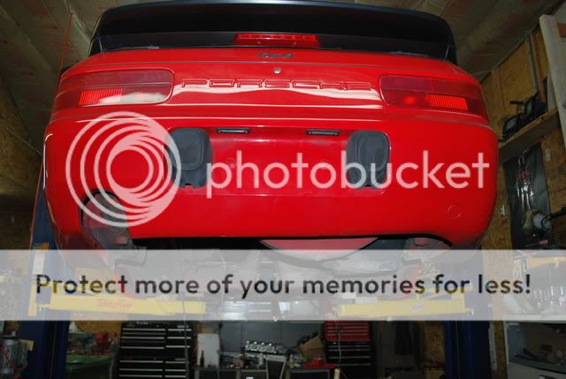

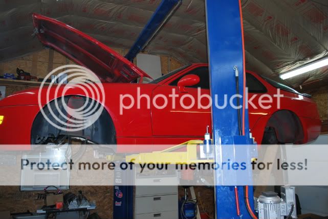

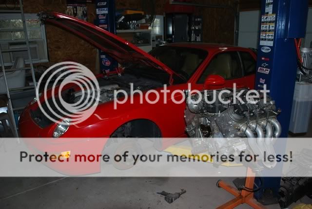

The engine and suspension are out, now it's time to start cutting and removing all the unnecessary brackets. I think I am going to apply all new undercoating while everything is removed from under the car.
968 LS1 Swap Picture153
968 LS1 Swap Picture152
Does anyone need a 968 Rear Axle Assembly? I heard it has larger torsion bars!!!
968 LS1 Swap Picture154
